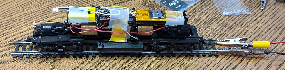

I took a cue from the original installation video, and from the condition of the returned board and mounting platform, to use Kapton® tape for corralling wires and for making other attachments. I had not given tape much consideration with respect to the overall decoder board installation. I had lots of vinyl electrical tape on hand, and I just used that. The vinyl tape that I was using was approximately 6 mils thick. Having made a lot of caliper measurements, I realized that when I was dealing with clearances of a few thousandths of an inch, the thickness of a couple of pieces of vinyl tape could add up and pose a problem with the fit of the shell.
Therefore, I purchased a package of Kapton® tape with four rolls each of different widths. The four different widths provided options for insulation and tacking down wires and so forth. The Kapton® tape is just 1 mil thick. Kapton® film was extensively used by NASA in the Webb space telescope, i.e., it is good stuff.
In a case in point, I had used vinyl tape to insulate the locomotive frame from the underside motor contact clip as in Photo #10 above. In the third installation, I replaced the 6-mil thick vinyl tape with the 1-mil thick Kapton® tape. With this replacement, I reduced the overall height of the motor and decoder board assembly by approximately 5 mils. During the third installation, I realized that the underside motor contact had a small blob of excess solder. I carefully removed that with a solder wick. Removing that excess solder might have provided another mil or two reduction in the finished height of the motor and decoder board assembly. Little things like this might not matter in many electronic or modeling efforts, but they seemed to be important to consider and to deal with in this case.
The solder wire that I had on hand had a diameter of 2 mm. In addition to the mass of some of the locomotive frame and motor parts, that size of solder wire took a lot of heat to melt, i.e., strike three against using my old soldering iron. The third thing that I ordered before attempting the third installation was a new roll of solder with a 1 mm thick wire. 0.5 mm diameter might have been even better for this project. Nevertheless, the new solder melts readily in the steady heat from the soldering station.
By this time, I knew where every color-coded wire extending from the edge of the decoder board needed to be attached. Honoring a hint from customer service, I cut the various wires as short as I could to allow the wires to reach between the decoder board and their respective destinations and still have enough slack in the wires for moving the board around while working with other wires. Then, I used the Kapton® tape to tack each wire down to the motor so that each wire was out of the way of the drivetrains and the space on the sides of the motor through which the shell had to pass.
After all of the wires were routed through the mounting platform holes and carefully soldered using the fine solder wire, I set the platform on top of the heat-deformed plastic of the motor frame. The platform would have fit snuggly had I not damaged the plastic in my rush during the first installation. Using another tip from customer support, I positioned the platform as well as I could over the irregular plastic and locked the board and platform assembly in place with a length of Kapton® tape. I used the widest tape in the pack that I had purchased. That piece of tape crosses over the assembly and attaches to each side of the motor. It takes some space on the sides and a bit on the top of the motor, but less than vinyl tape, and the taping is definitely more structurally stable than using blobs of the tacky blue stuff.
I tested the assembly on my small worktable track, and all seemed in good order. I decided to try to reattach the locomotive shell. This step had been a significant problem at one point in this process. My use of vinyl tape had probably been a defining factor. This time, however, with a minor condescension, as I will discuss later, I was able to slide the shell almost trivially into its proper position such that it actually locked to the frame.
I took the locomotive to my embryonic seasonal layout. The loop was composed of traditional nickel silver sectional track nailed through cork roadbed with the nails bottoming in the plywood baseboard. With years of experience, I knew to check each section joint to be sure that the rail ends were properly slipped into the joiners. I had more than one point at which I attached power to the tracks in order to minimize the effects of dirty tracks and the odd joiner that did not do its job in the DC world. I was reasonably confident that I had a good loop for testing the locomotive that was apparently, successfully LocoFi™-equipped.
By this time, I had set aside my old analog DC powerpack with the external filter capacitor, and I was using a small 12 V, 12 Ahr emergency battery for powering the track. That was a matter of convenience. The battery, with a handle, was easily moved between the test track in my craft room and the loop on the layout board in the alcove. The battery has a built-in voltmeter to monitor the battery’s charge, and it has an on-off switch for easily killing power to the track/decoder board after running my train, or in a malfunction.
I fired everything up. The horn and bell sounded. The engine started up, and the locomotive started to move. So far, so good. Sadly, the locomotive did not go far before the sounds stopped. I could still control the speed of the locomotive, and I brought it to a stop. I killed the power to the locomotive and wondered what this situation indicated. Another email to customer support resulted in a suggestion to reformat the SD card that holds the sound files and to reinstall the sound files. That seemed to cure the problem of dropped sounds.
Customer support also reminded me to be sure that I had clean track, i.e., the sound cutting out was a symptom of the decoder experiencing a momentary power drop. I tried wiping the tracks with isopropyl alcohol and with a cloth dampened with electronic contact cleaner spray. That made a small difference, but not one that I could count on around the entire loop or on an industrial siding. The decoder board would still lose power at random locations on the track. These were different from the momentary drops that had affected the sounds. The locomotive would be dead on the tracks. Only a cold reboot of the entire system would allow me to start the locomotive again.
Occasionally, the locomotive would make a complete lap around the track loop. When I got lucky in this way, I would increase the speed such that the power drops were not critical, i.e., the on-board capacitor would hold the power for the decoder up until power from the tracks was restored. Part of my logic here was that letting the locomotive run might wear tarnish off of the tracks and wheels, but I do not think that much, if anything, was gained by this tactic.
I decided to pull up all of the neatly nailed sectional track and purchase new Bachmann E-Z Track®. My logic was that new track should not suffer from odd bits of tarnish on rails and between rails and joiners such as the 25+ year old track sections might have had.
Still, with the new track, I got erratic behavior from my locomotive. I was confident that the problem was not an installation issue, and dirty track would seem to have been obviated. Yet, I had some issue of power delivery to the decoder board. I wondered about the wheels. I took the locomotive back to my worktable and studied the wheels under a bright light and a magnifier. Indeed, here and there were small blobs of tarnish. As with the new tracks, I gained some performance benefit after trying to clean the wheels, but I would still get power drops.
Finally, one morning, I woke up with the idea that maybe the inside surfaces of the flanges on the wheels were not making good contact with the wipers that led to the power wires for the decoder board. I recalled that I had purchased a package of model train lubricants a few years earlier and that one product in the package was labeled as conducting to be placed on the motor brushes. I thought that a drop or two of the conducting lubricant would not hurt the flange to wiper contacts. .
Indeed, not having continuous contact between the flanges and the wipers would seem to have been the last loose nut. In fact, it may well have been the most significant culprit underlying the power supply issue all along. Maybe my carefully nailed down sectional track, wiped with solvents, was good enough after all. Maybe I could have saved the money on the new track, though I do like its ease of assembly, which is a factor in the wintertime craft philosophy, and I like the uniform look of the roadbed. Then, I remembered the old admonition of not placing the layout on a floor, particularly a carpeted floor. Maybe that episode from the early 1990’s came back to haunt me after all. I shared my apparent success with customer support and by return email, I was told that the conducting lubricant idea was discussed in item #3 in their troubleshooting tips for curing power drops. I was surprised, and a bit embarrassed, that I had missed that on the website.
The locomotive was running fine at this point. However, during this installation, I took some shortcuts and made compromises in order to speed up getting the locomotive running on my layout. In Photo #14 above, you can see that the headlight wires are terminated with heat shrink tubing, i.e., I had not attempted to attach the LED headlight/cab light assembly. I figured that I could live without the light. In an attempt to help you to understand my thought process, I am including an exploded diagram of the Athearn locomotive shell.
With the decoder board mounted on top of the motor, the shell would not slide into place and lock onto the frame. While I could not see inside the shell, in studying the exploded diagram, I imagined that the speaker extended through the opening, i.e., the red-outlined yellow box in the exploded view, in the main part of the shell just enough to block the back side of the Cab Windows insert, i.e., the red box on the Cab Window piece.
In the first shortcut, I pried the Cab and the Cab Windows out of the shell and slid the clear plastic windows piece out of the Cab. It was not cemented in or locked in with tabs. I reattached the Cab to the rest of the shell and tried to connect the shell to the locomotive frame. As I mentioned earlier, the shell did slide relatively easily into place and lock to the frame. At that moment, I was more concerned with getting the locomotive running on my layout, and I did not worry about the light, i.e., a bit of a compromise or taking a shortcut.
However, after the sound and the power dropping issues were handled, I wondered whether I could attach the light in the open space inside the cab. I was encouraged to do so by LocoFi™ support but warned that installing the light could be a challenge, i.e., one of those locomotive-specific, mechanical issues that I mentioned above. I was reasonably sure that I knew what to try. I would use my razor saw to cut out the area of the red box in the back of the Cab Window piece. That was easily done. With the window reinserted into the Cab and the Cab reattached to the shell, the shell still slipped over the motor and locked to the frame.
I could have quit there. At least, I had the windows back. However, I decided to evaluate the light one more time. The blue and white wires had been routed from the decoder circuit board past the speaker and through a pair of holes on the front of the mounting platform. The LED had been prepared with lengths of blue and white wire to provide flexibility in where the light was placed. After some study and, perhaps, a coin toss, I decided to remove the Cab/Windows assembly from the shell again and mount the LED in the top of the Cab holding the light in place with hot glue. With the LED glued into place, I reattached the Cab/Windows piece to the rest of the shell. I did a fit test to be sure that something unforeseen was not preventing the shell from attaching to the frame. Passing the test, I then had to solder the LED blue and white wires to their respective mates with the shell flopping around next to the rest of the locomotive. That was a bit of a challenge, but I got it done.
I placed the locomotive on my layout to test the light. The light worked as expected, and in the process of installing the light, I did not seem to have disturbed any other aspect of the installation.
Now, my old DC locomotive, outfitted with the Generation Two LocoFi™ decoder board, seems to be working just as I had expected several years ago when I started this process. I was successful in large part as a result of the untiring mentoring of LocoFi customer service. However, the path might have been shortened if I had been a little more patient, if I had taken time to better understand the scope of the project through reading and re-reading the installation and troubleshooting tips and watching the videos on the LocoFi website, and if I had made sure that I had suitable tools and supplies for the project.
